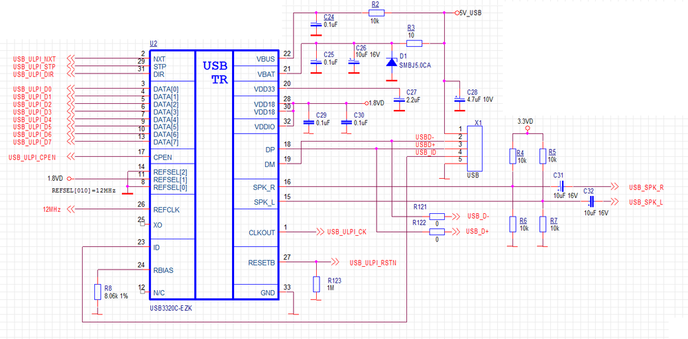

Hi colleagues!
I suppose this is old topic, but I haven't found the solution yet. what I have: 1. Modified STM32F4_discovery: removed microphone, and some resistors for avoiding conflict with ULPI interface. 2. Board with USB3320, which connected by connectors. Scheme:2013-12-13 12:18 PM
What I did wrong?
The most obvious one would be that the VDDIO is the voltage for the ULPI interface, and that's NOT 1.8V2013-12-15 8:46 PM
Clive,
My MCU works with 1.8V logic level. And VDDIO could be either 1.8V or 3.3V.2013-12-16 4:40 AM
So you modified the STM32F4-Discovery supply? The operating voltage specified for USB HS is 2.7V to 3.6V2013-12-16 11:59 PM
Oops! I missed it in datasheet. :( Will check!
2013-12-17 10:01 PM
Change power from MCU and VDDIO from 1.8V to 3.3V.
USB3320 VDD18 = 2.0V. Check power-up sequence VDD1.8(2V) - the first, then VDDIO=3.3V But it didn't help....:(2014-03-27 11:30 PM
The troubles were in the long wires. Everything is working at PCB.
