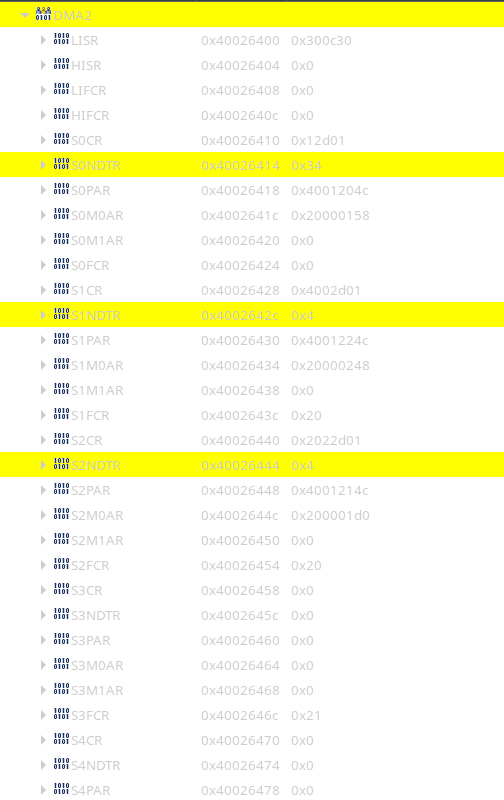

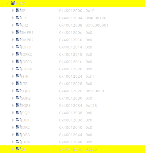

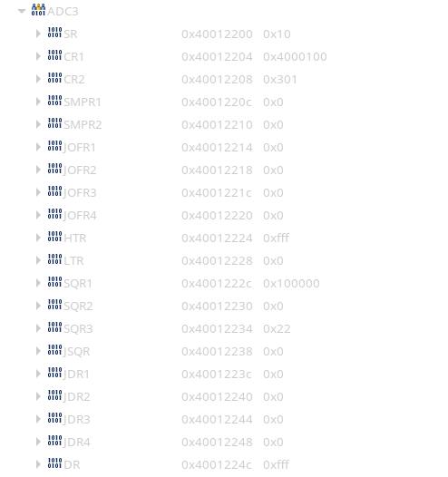

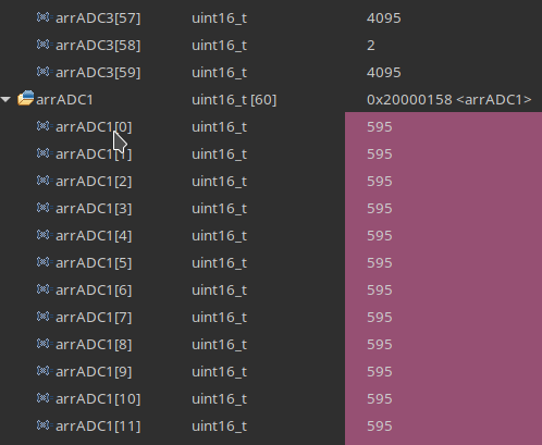

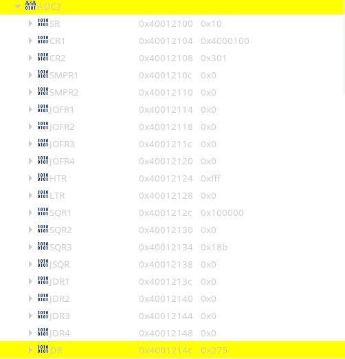

I config ADC with DMA and TIM2. By TIM2 overflow starts ADC process for ADC1 ADC2 and ADC3 simultaneously. DMA collect ADC data and store to RAM. In debug i see that DMA for ADC1 transfer the same ADC data several times.
For example:
ADC1: 32, 32, 32, 32, 32, 32, 32 11, 11, 11, 11, 11
ADC2: 32, 11
ADC3: 32, 11
Problem not with ADC1. I arrange interrupt after end of conversion. It's interrupts by TIM2.

static void MX_ADC1_Init(void)
/* USER CODE BEGIN ADC1_Init 0 */
//ADC1->CR1 |= ADC_CR1_EOCIE;
/* USER CODE END ADC1_Init 0 */
ADC_MultiModeTypeDef multimode = {0};
ADC_ChannelConfTypeDef sConfig = {0};
/* USER CODE BEGIN ADC1_Init 1 */
HAL_NVIC_SetPriority(ADC_IRQn, 4, 0);
HAL_NVIC_EnableIRQ(ADC_IRQn);
/* USER CODE END ADC1_Init 1 */
/** Configure the global features of the ADC (Clock, Resolution, Data Alignment and number of conversion)
hadc1.Instance = ADC1;
hadc1.Init.ClockPrescaler = ADC_CLOCK_SYNC_PCLK_DIV4;
hadc1.Init.Resolution = ADC_RESOLUTION_12B;
hadc1.Init.ScanConvMode = ENABLE;
hadc1.Init.ContinuousConvMode = DISABLE;
hadc1.Init.DiscontinuousConvMode = DISABLE;
hadc1.Init.ExternalTrigConvEdge = ADC_EXTERNALTRIGCONVEDGE_RISING;
hadc1.Init.ExternalTrigConv = ADC_EXTERNALTRIGCONV_T2_TRGO;
hadc1.Init.DataAlign = ADC_DATAALIGN_RIGHT;
hadc1.Init.NbrOfConversion = 2;
hadc1.Init.DMAContinuousRequests = ENABLE;
hadc1.Init.EOCSelection = ADC_EOC_SEQ_CONV;
if (HAL_ADC_Init(&hadc1) != HAL_OK)
Error_Handler();
/** Configure the ADC multi-mode
multimode.Mode = ADC_TRIPLEMODE_REGSIMULT;
multimode.DMAAccessMode = ADC_DMAACCESSMODE_1;
multimode.TwoSamplingDelay = ADC_TWOSAMPLINGDELAY_5CYCLES;
if (HAL_ADCEx_MultiModeConfigChannel(&hadc1, &multimode) != HAL_OK)
Error_Handler();
/** Configure for the selected ADC regular channel its corresponding rank in the sequencer and its sample time.
sConfig.Channel = ADC_CHANNEL_8;
sConfig.Rank = 1;
sConfig.SamplingTime = ADC_SAMPLETIME_3CYCLES;
if (HAL_ADC_ConfigChannel(&hadc1, &sConfig) != HAL_OK)
Error_Handler();
sConfig.Channel = ADC_CHANNEL_9;
sConfig.Rank = 2;
Error_Handler();
/* USER CODE BEGIN ADC1_Init 2 */
/* USER CODE END ADC1_Init 2 */

static void MX_ADC2_Init(void)
/* USER CODE BEGIN ADC2_Init 0 */
/* USER CODE END ADC2_Init 0 */
/* USER CODE BEGIN ADC2_Init 1 */
/* USER CODE END ADC2_Init 1 */
hadc2.Instance = ADC2;
hadc2.Init.ClockPrescaler = ADC_CLOCK_SYNC_PCLK_DIV4;
hadc2.Init.Resolution = ADC_RESOLUTION_12B;
hadc2.Init.ScanConvMode = ENABLE;
hadc2.Init.ContinuousConvMode = DISABLE;
hadc2.Init.DiscontinuousConvMode = DISABLE;
hadc2.Init.DataAlign = ADC_DATAALIGN_RIGHT;
hadc2.Init.NbrOfConversion = 2;
hadc2.Init.DMAContinuousRequests = ENABLE;
hadc2.Init.EOCSelection = ADC_EOC_SEQ_CONV;
if (HAL_ADC_Init(&hadc2) != HAL_OK)
Error_Handler();
sConfig.Channel = ADC_CHANNEL_11;
sConfig.Rank = 1;
if (HAL_ADC_ConfigChannel(&hadc2, &sConfig) != HAL_OK)
Error_Handler();
/* USER CODE BEGIN ADC2_Init 2 */
sConfig.Channel = ADC_CHANNEL_12;
sConfig.Rank =2;
Error_Handler();
/* USER CODE END ADC2_Init 2 */

static void MX_ADC3_Init(void)
/* USER CODE BEGIN ADC3_Init 0 */
/* USER CODE END ADC3_Init 0 */
/* USER CODE BEGIN ADC3_Init 1 */
/* USER CODE END ADC3_Init 1 */
hadc3.Instance = ADC3;
hadc3.Init.ClockPrescaler = ADC_CLOCK_SYNC_PCLK_DIV4;
hadc3.Init.Resolution = ADC_RESOLUTION_12B;
hadc3.Init.ScanConvMode = ENABLE;
hadc3.Init.ContinuousConvMode = DISABLE;
hadc3.Init.DiscontinuousConvMode = DISABLE;
hadc3.Init.DataAlign = ADC_DATAALIGN_RIGHT;
hadc3.Init.NbrOfConversion = 2;
hadc3.Init.DMAContinuousRequests = ENABLE;
hadc3.Init.EOCSelection = ADC_EOC_SEQ_CONV;
if (HAL_ADC_Init(&hadc3) != HAL_OK)
Error_Handler();
sConfig.Channel = ADC_CHANNEL_1;
sConfig.Rank = 2;
if (HAL_ADC_ConfigChannel(&hadc3, &sConfig) != HAL_OK)
Error_Handler();
sConfig.Channel = ADC_CHANNEL_2;
sConfig.Rank = 1;
Error_Handler();
/* USER CODE BEGIN ADC3_Init 2 */
/* USER CODE END ADC3_Init 2 */

I use 3 DMA stream and 3 data buffer. In debug all stream DMA registers are similar. But data buffer for master ADC1 filled by repeated data.
2020-04-28 8:09 AM
On picture - in arrADC3 - data from two adc channels. It OK. But in arrADC1 - repeated data from only one channel!
2020-04-28 12:38 PM
Read out and post content of ADC and DMA registers.
