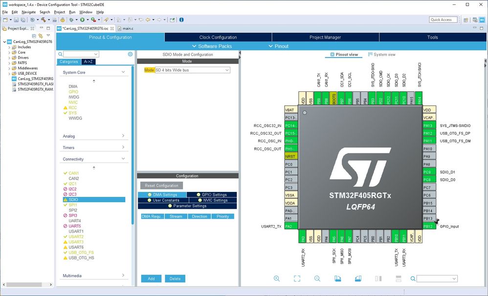

The following is my screen shot:
Please assist.

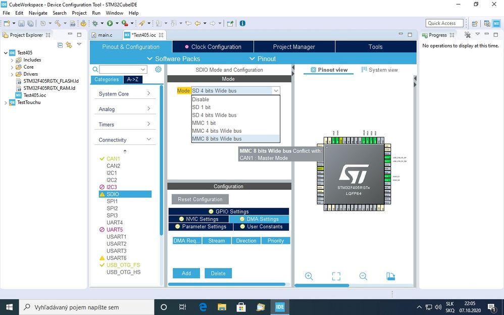

Warning is not problem only report that some function here SDIO is impossible,
for your config was in conflict MMC8bits mode SDIO

2020-10-07 10:39 PM
> 1. Is it possible to enable USB_OTG_FS, CAN and SDIO for this MCU? (I’m assuming YES.)
As of your last screen dump: yes
> 2. What is this conflict? How can the conflict be mitigated?
Yellow means that there are some configurations of SDIO which conflict. As @MM..1 said and showed: if you drop down the list of possible SDIO configurations, some, but not all, are red. In this particular case only one SDIO config conflicts: SDIO using as MMIO with 8-bit wide data bus.
Mitigation: dont use SDIO in MMIO with 8-bit wide data bus mode (I think you never wanted that mode).
There is no conflict if you select SD 4 bits wide mode for example.
