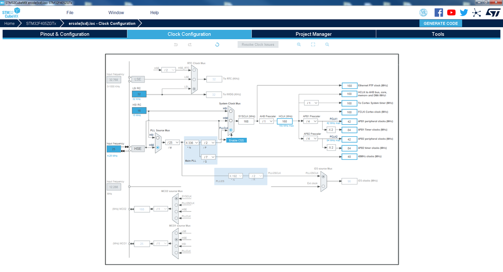

2021-05-16 11:55 PM
Hello Petr. The MCU is STM32F405ZGT6. In the GPIO settings on Cube I selected no pull up and no pull down. This is the clock configuration.In the STM32CubeF4 package there are no examples for boards with the same MCU. What could be the most similar to the one that I am using?

Hello VCapu,
according to RM0090, STM32F405xx/07xx and STM32F415xx/17xx all should be really similar together and from this reason I would go for examples in folder STM324xG_EVAL. There is also code for custom hid example. Do I understand it correctly that you have external pull-up resistor at the D+ line and external oscillator on your custom board?
