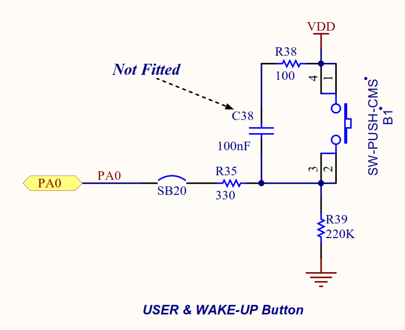

I have just noticed that my configuration works, but I havent seen it, because the signal amplitude is 1.5V, instead of 3.3V as I expected... I checked the STM32F4 discovery schematic and noticed that PA0 is biased (It shouldnt have anything to do with it though). But to be sure i swapped to uart5, but there amplitude is 1.5V as well. Is there something I forgot or dont know about? Are IO's in stm32f4 powered with 1.5V?

Is the Uart connected to anything at all Ie a RS232 Driver Level Chip? Otherwise maybe Loading it down
Check all your VDD Supplys are are OK2015-04-03 9:47 AM

Hello and thank you for answers. I have checked the schematic and the button connected has no effect on the line.
