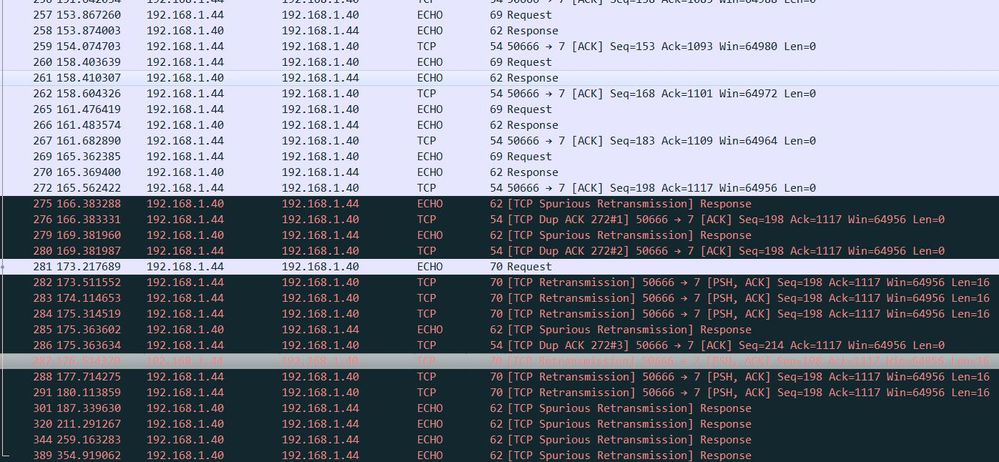

I have configured STM32 as a server using tcp_echoserver example. I'm receiving data through tcp_echoserver_revc() function.
I'm receiving packets in this way: #INIT*
When STM32 receive X packets (Around 14), it stops receiving data and TCP connection disconnects from PC. However, STM32 still working normally (except lwip part). It can't receive or send any packet.
All configuration is by default, IP fixed.
This is a capture from wireshark. 192.168.1.40 is the IP of STM32. When STM32 fails, black lines appear.
As I say, it is all by default. I have only modified tcp_echoserver.c file. I write below functions that belongs to that file.
2019-09-04 3:06 AM

2019-09-06 12:45 AM
I have use tcp_echoserver.c file by default, adding these lines in order to save data into a buffer, it works fine. However, it's always making echo.
memcpy(&BufferAux,p->payload,p->len);
pos = 0;
while (pos < p->len){
BufferETH[BuffPosIn_ETH++] = BufferAux[pos++];
if (BuffPosIn_ETH >= sizeof(BufferETH))
BuffPosIn_ETH = 0;
memcpy(&BufferAux,0,sizeof(BufferAux));Anyone can help me? Thanks.
2019-09-06 1:54 AM
Not much experience with ethernet applications on STM32.
But the observed effect reminds me similar problems with other serial peripherals and demo projects. If a problem like overflow happens, reception effectively stops until you explicitly clear the respective error flag.
Some examples and demo projects exhibit a "walk in the sunshine" approach, i.e. they bravely skip most error checking and processing.
2019-09-06 2:42 AM
In my case, I think there's a buffer or memory problem, but I can't find it.
