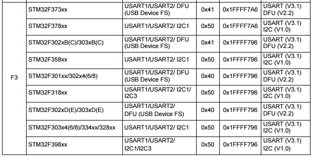

Hello
J.Prasant
,CAN bootloaderis not applicable for STM32F
I recommend that you have a look to the application note ''STM32 microcontroller system memory boot mode''
and you find related information to the STM32F303 bootloader . You can refer to this ''CAN protocol used in the STM32 bootloader'' and checkApplicable products.Regards
Imen
