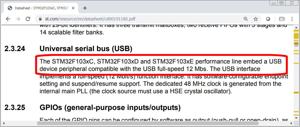

The datasheet tells you that it has USB Device:
So that's not Host (nor OTG).
