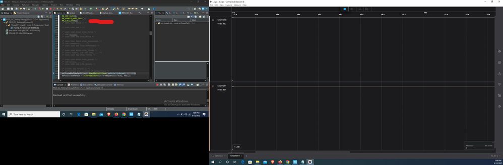

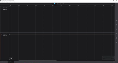

2025-06-11 6:03 AM
You need to probe what is going-on on the bus using an oscilloscope or a logic analyzer.
You need also to refer to the sensor datasheet to know what that "8" value means!
Try also to declare uint8_t check; global and test.

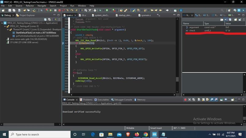

2025-06-11 6:59 AM
what you mean by going-on on the bus. and 8 is the value of local variable uint8_t check; if i declarer it as globule variable value showing "0".
2025-06-11 7:10 AM - edited 2025-06-11 7:11 AM
You need to check what happens on the I2C bus by probing SDA/SDL lines using a logic analyzer. This is the efficient way to debug the issue.
As the following?:
/* USER CODE BEGIN PV */
uint8_t check;
/* USER CODE END PV */
/* USER CODE END Header_StartDefaultTask */
void StartDefaultTask(void const * argument)
/* USER CODE BEGIN 5 */
HAL_I2C_Mem_Read(&hi2c1, (0x69 << 1), 0x00, 1, &check,1, 100);
if (check==234)
HAL_GPIO_WritePin(GPIOA, GPIO_PIN_7, GPIO_PIN_SET);
else
HAL_GPIO_WritePin(GPIOA, GPIO_PIN_7, GPIO_PIN_RESET);
/* Infinite loop */
for(;;)
ICM20948_Read_Accel(&hi2c1, &ICMData, ICM20948_ADDR);
osDelay(100);
/* USER CODE END 5 */
Try also to decrease the optimization of the compiler.
What if you call :
before calling StartDefaultTask()?
But again you need to probe the SDA/SCL lines and see if you see that magic value "234" when reading the sensor.

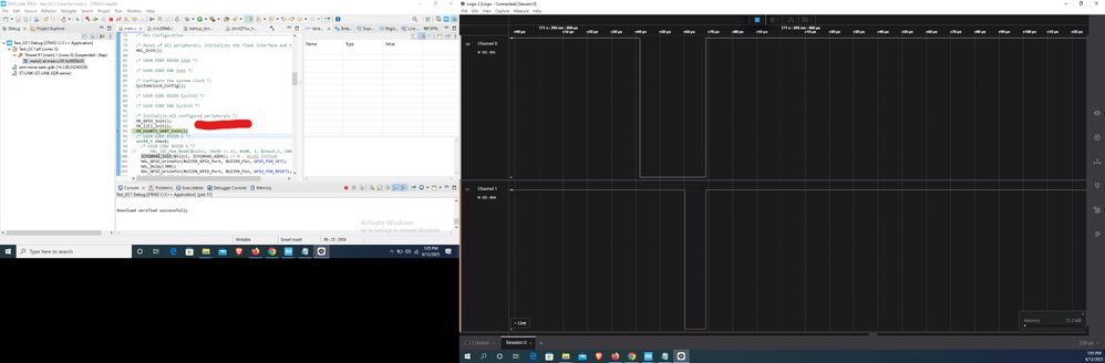

2025-06-12 12:55 AM - edited 2025-06-12 12:58 AM
I am using logic analyzer and finding this graph that is non rots project MX_I2C1_Init(); initialize successfully in first image but with RTOS project MX_I2C1_Init(); not initialized (graph showing in 2nd image with dark theme). Now what should i do because connection is same for both project. i2c is by default configured in rots also. Is there any specific config please mentioned.

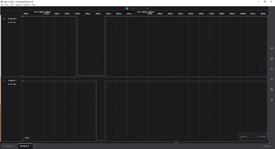

So this is the working one, without RTOS:
Yes?
You've only shown the very start here - you need to show the complete transaction.
And this is the non-working one, with RTOS:
Yes?
In that one, I don't see anything happening at all ?
Clearly, if nothing is happening on the I2C bus lines, then there is no communication!
