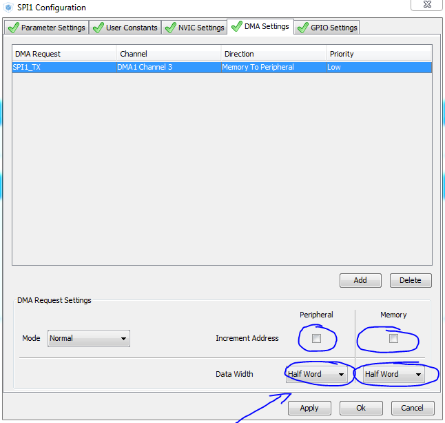

I belive that you need to reconfigure SPI for DataSize of 16bits, obviusly set DMA to transmit halfword for both peripheral and mem. Then you can simply call HAL_SPI_Transmit_DMA with a pointer to 16bit variable. You might get some compiler errors either ignore or cast the uint8_t*. Any should work anyway.

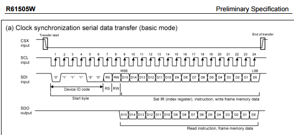

Thank You so much for sugesstion, that would work if I would not need to send 24 bits as general commands. I`m communicating with LCD thru R61505W TFT contoller. that kind communication requires in general command of 24 bits as below:
so if I change the 8 bits to 16 bits that makes instead of sending 3 bytes (- refering to above picture ) two halfwords (which does not corespond to above diagram)
byte1 (Device ID code+RS+RW)
byte2 (MSB 8 bits)
byte3 (LSB 8 bits)
total 24 bits as required above
If I switch to 16 bits I would have to send
halfword1 (16 bits)
halfword2 (16 bits)
(32 bits in total -does not match 24 bits)
so in general as example instead of sending command as example
0x70 (device ID Code+RS+RW 8 bits)
0x34 (MSB 8 bits)
0x65 (LSB 8 bits)
after switching to 16 bits I woud have to send command as
0x0070
(device ID Code+RS+RW BUT THAT WOULD BE 16 bits -wrong)
0x3465 (MSB+LSB 16 bits)
and that would not match the timming graph above.
So, maybe I would have to stick with 8 bits and at some point will have to switch to 16 bits where in need to transfer thru DMA?
How can I switch from 8 to 16bits in runtime?
I hope I dont have to reconfigure thru ''Init'' statement as below? Is there any other way?
