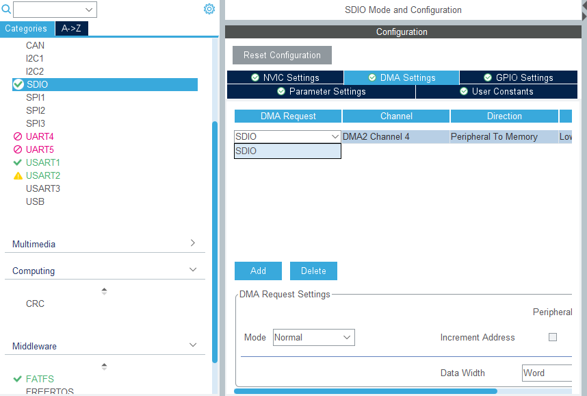

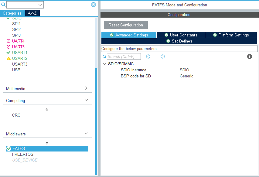

I've tried to test sdcard with fatfs on STM32F103RCT6.
I don't have a compleat 100% sure hardware or software, so I'm struggling to debug if its a software or hardware issue.
I've read trough some topics hear, one with issue with https://community.st.com/s/question/0D50X00009XkWceSAF/stm32f411re-stm32cube-fatfs-sdio-sdcard-always-returns-frdiskerr
I tried to set DMA along the link, but SDIO_RX and SDIO_TX were not found.
Also, I couldn't find the 'Use dma template' item in FATFS settings.

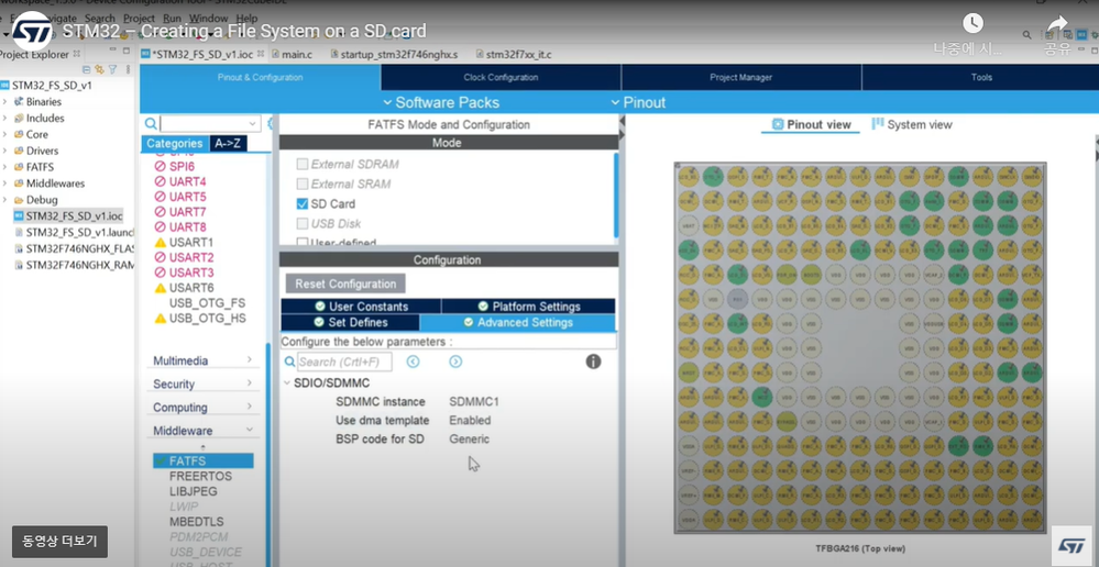

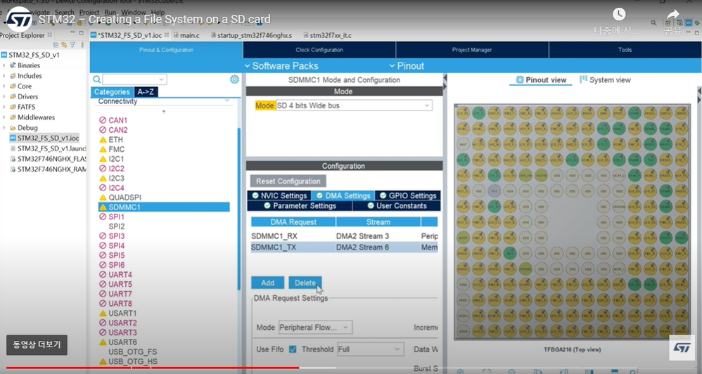

2021-10-28 3:08 AM
Thanks @Walid ZRELLI for the reply.
The STM32F7 series in the video you linked can set both RX and TX DMA settings,
But the STM32F1 series cannot settings.
Is it impossible to set DMA RX, TX in the .ioc file for STM32F1 series?
Is there no other way?
I would very much appreciate it if you confirm this question.
Best regards,
Robert
2021-10-28 3:51 AM
Hello @RKim.1
This is normal because as mentioned in the reference manual SDIO DMA settings can only be configured on DMA2 Channel4 with peripheral to memory direction.
You can refer to the Reference manual.
BeST Regards,
Walid
