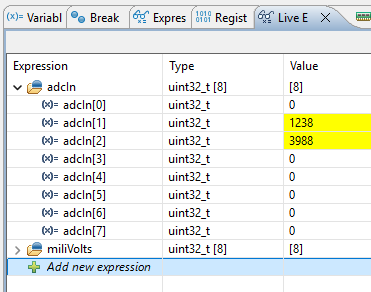

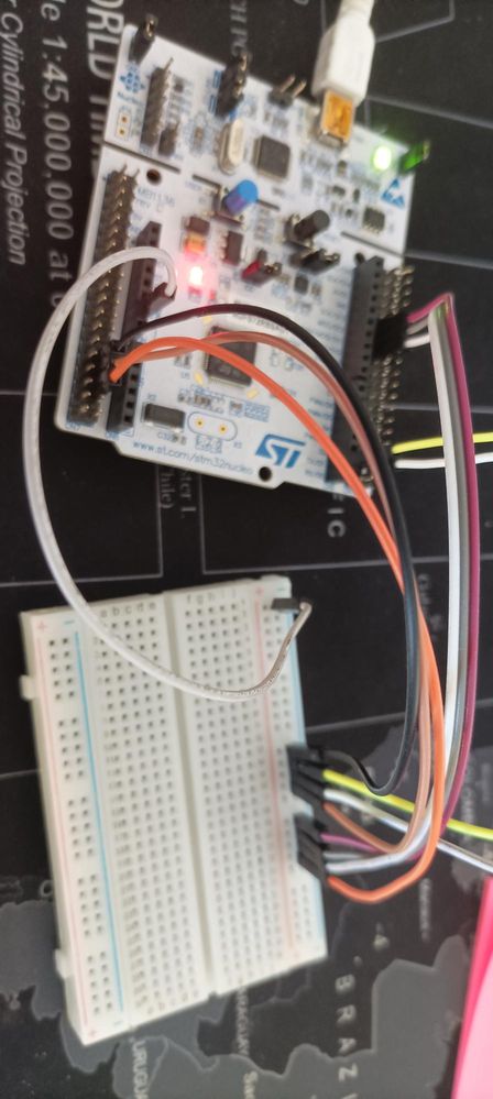

Hi, I need to read 8 channels through the ADC in DMA circular mode, to check the channel status readd I put all channel to GND from nucleo board and two channels (ADC_IN2 on PA2 pin and ADC_IN3 on PA3 pin ) doesn't give me the correct data, you can see in the image all channels to 0 except this two.
I try change the wires but isn't the problem.
All code is generated from MX tool.
Can anyone tell me why these two channels are not working?
Attached is the entire project.

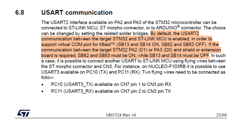

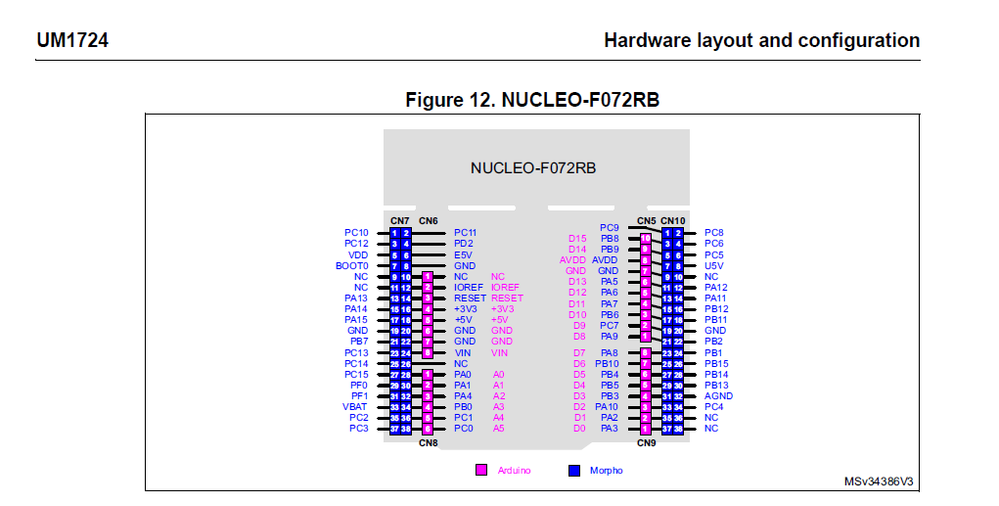

This is nucleo board, likely PA2 & PA3 assign to serial port. Locate product description page on ST.com, navigate to CAD docs - get schematic. Also download and study nucleo board manual.
2025-04-24 1:43 AM

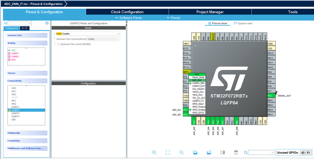

Hi @MasterT , before to start this project I reset all pins, and use this layout from the file attached.
2025-04-24 2:00 AM
"Reset" doesn't help here, since hardware is overrule any software nuisance. Pins likely attached to arduino D0 & D1 header, so there bias voltage is always there. General rules are: not every pin is available for user, study docs before do "reset"

2025-05-01 11:38 AM
I'm thinking that @MasterT argument is right.
I assume that by default in this board the USART2 is enabled through the bridges and maybe I need change it to the channels in this pins works fine.
This time I am not going to check it and I abandon this idea to use other methods to achieve my goal.
Thanks to all.
