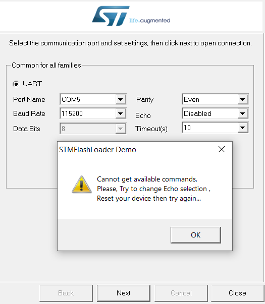

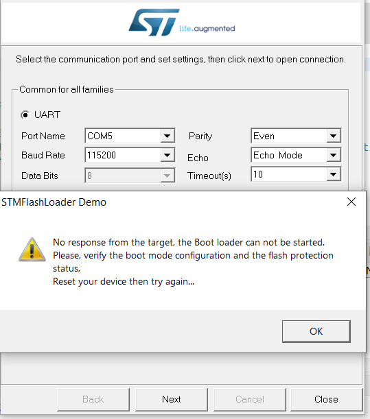

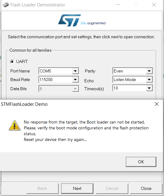

SYSCFG->CFGR1 = 0x01;So now it doesn't end up in a Hard Fault interrupt. However, I haven't been able to connect using the Flash Loader Demonstrator. I have tried all 3 options for Echo without luck.

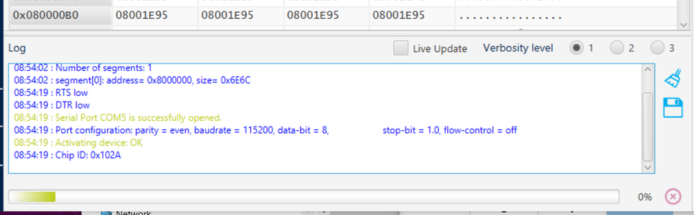

Using the STM32CubeProgrammer UART, I get it to connect, but haven't been able to flash anything. It stays with the loading bar ping-ponging without ever increasing from 0%.
What am I missing here?

Thanks for your assistance. Based on your input I decided to call the DeInit functions for each and every peripheral currently used by my application as well as disabling all interrupts enabled by my application. I followed the reverse Initialization order while doing it.
Here's the final code tested to work using the Flash Demonstrator app:
