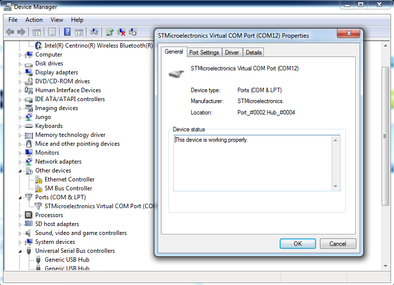

Does your device enumerate correctly when plugged into a PC?2014-02-25 8:25 AM
i guess it does, im not sure how can i understand that. But here it looks okay:

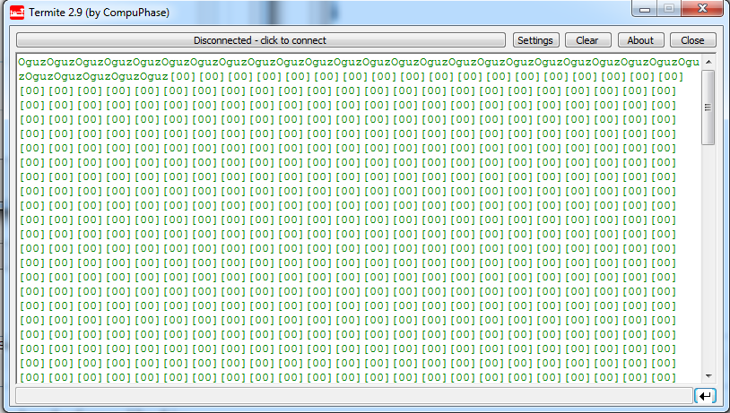

Device Manager:UserToPMABufferCopy((unsigned
char
*)ozee, INT_IN_TX_ADDRESS, Send_length);
SetEPTxCount(ENDP1, Send_length);
SetEPTxValid(ENDP1);
When i did that it sends data over USB, but after some data sent to PC it sending bunch of zeros like this:
2014-02-26 6:03 AM
Hi
OK, so the USB stack for the most part is working OK. It enumerates and data can be transferred. From the symptoms you describe, it sounds like the code in usb_cdc_vcp.c is not doing what it is suppose to do. The buffer 'APP_Rx_Buffer[]' should contain the data to send to the host. It uses a pointer 'APP_Rx_ptr_in' should point to the end of the buffer when you have inserted what you want to transmit. How does it work - go search for it in the code and figure it out! Incidentally, the code as provided uses the same buffer to get data from the host. I did not like that, so I created a separate buffer for that in my code.2016-11-07 12:30 AM
