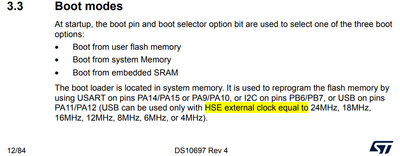

2025-07-31 2:42 AM
It is mentioned that bootloader over USB can be used only with HSE external clock (4MHz, 6MHz..)
I had seen a similar issue on F070, and workaround adopted was to insert a FS hub.

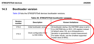

2025-07-31 4:37 AM
2025-07-31 5:44 AM
This may be the root cause of problems both with USB and UART (with no external oscillator).
The same issue is there for 'F042. That it works may be a coincidence, as exact effect of HSITRIM is process-dependent, (complicated by the fact that HSITRIM is added to the factory-set HSICAL, and their combined effect will be some 5-10% off nominal, I guess) and varies from piece to piece.
There may be no sane solution(*) for the USB case. For UART case, you can try a couple of baudrates around (below) the nominal, if you have such control over the PC-end of software.
Given the 'F0 family is more than 10 years old at this point, unless you present $M++ purchasing power (in which case you are not likely to ask here), I highly doubt ST will ever fix this.
(*) Oh, and the insane one would be a contraption with one upstream (device) and one downstream (host) USB port (e.g. an STM32F4 with one USB module as device and other as host), where the downstream (host) would be capable of running the USB at frequencies adequate to the incorrectly detected HSE, e.g. 18MHz instead of 16MHz; attempting to "relay" the DFU protocol. This may be complete impossible due to latencies, and also USB modules/PHYs may not be willing to run at the different baudrate.
I can't explain why would a hub mentioned by @FBL help.
