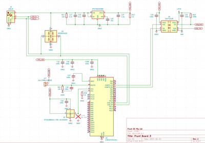

We have a STM32070CBT6 with minimal connections (schematic below) and it appears to be unresponsive to USB enumeration, although it does pull DP low to trigger it. This occurs when hotplugging it or holding reset low for a few seconds. I've checked the input on PF0 and it is getting a clean 16 MHz.

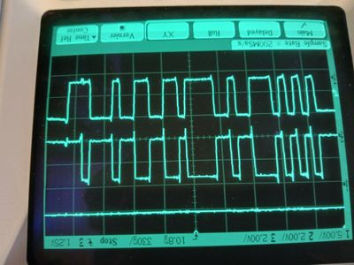

[ 3969.457853] usb 1-1-port1: unable to enumerate USB deviceWith a scope I see the pull down and then the setup packets going through every address from the host but no response from the STM32.
2025-07-17 12:50 AM
You can decode the packet if you like, but I've tried on multiple machines so I doubt this is a USB driver issue. None of the packets are longer than this so I assume they're all setup packets.

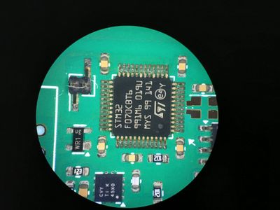

Here are the package markings for reference as some searching of this forum shows that many others have reported the same issue and some have also reported that it was fixed by different revisions.
