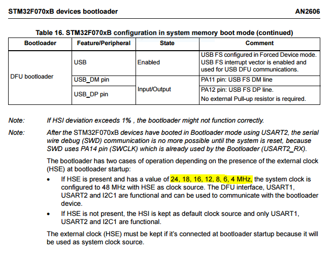

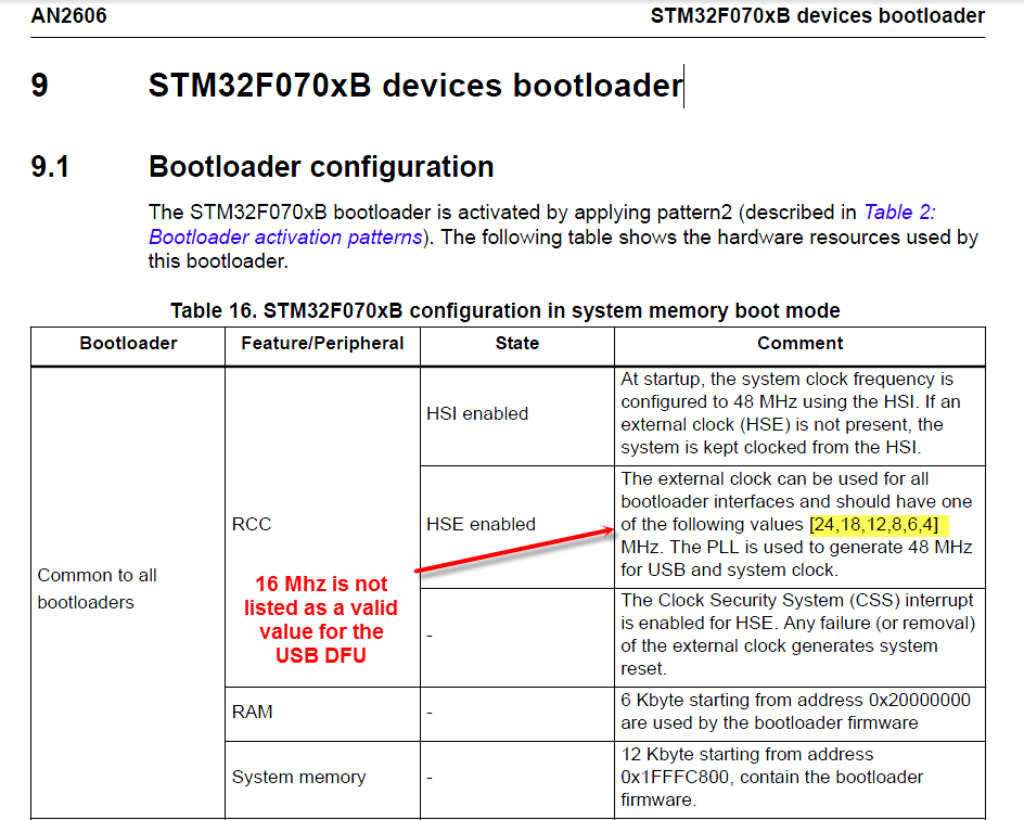

I'm using an external clock (HSE) with 16MHz.
See AN2606 - Section 9 for the STM32F070xB devices bootloader details.
Not 100% sure this is your issue but worth a review. Hope to know more next week when we test the same concepts of the USB interface using the STM32F070 target. Assorted users are reporting issues with using the STM32F070 (present on the Nucleo) while strapping BOOT0 to Vdd and receiving an ''Unknown Device'' in the Device Manager (Windows) - while the STM32F070F6P6 (20 pin TSSOP) is working. In both cases, 8 mhz was used as an external clock permit USB to be clocked as required.

Thanks, I also saw 16MHz missing on the page but one page later ST writes 16 MHz is valid for DFU.
