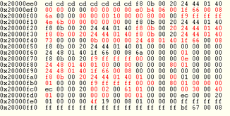

To help those who will be interested in, the linker compiler file (.icf) places the heap and stack in an arbitrary order. This can be fixed using
define block FIXED_ORDER_RAM with fixed order { block CSTACK, block HEAP};
place in RAM_region { readwrite, last block FIXED_ORDER_RAM };instead of the initial
place in RAM_region { readwrite, block CSTACK, block HEAP };Nevertheless, I still do not see any 1K range of Heap memory at the end of my RAM memory ranged (I can see it from the debugger and the stack usage tool which place a pattern before running).
And this obversation is coherent with the fact that when I reduce the heap size, my issue is not fixed (my RAM is still considered as full)
Is there any way that, despite the size is specified, that the compiler/linker (for some reason) do not implement heap at all ?
