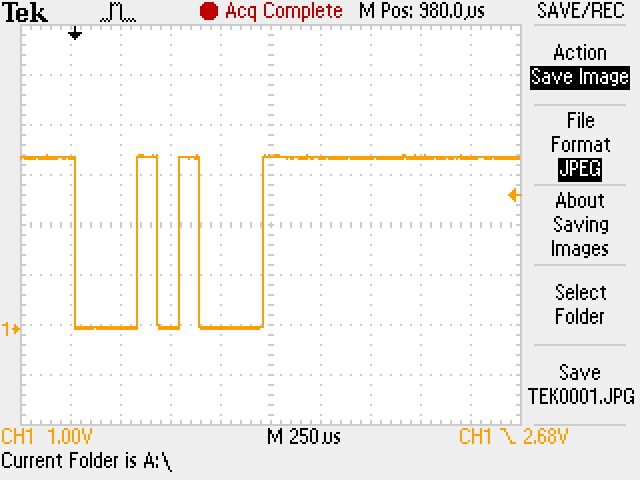

I also measured with the oscilloscope already on pin PA10 and I see the data package there.

If the transmitted packet looks right on the scope (can you post a screenshot?) then there's nothing to improve on the STM32 side.

I checked with the scope that data package see attachment. The value on the scope is 0x14 which is what I send.
Also when I bridged Tx and Rx on the FDTI cable. The reply was as it was supposed to be. Timing measured with the oscilloscope cursors was 100 microseconds per bit. I calculated 104 micro seconds for one bit for a baud rate of 9600.
