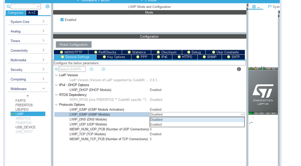

I am using a a very recent version of STM32CubeIDE (Version: 1.3.1) and STM32CubeMX (5.6.1.202004052303). I created a new project for the Nucleo-F207ZG board.
I have enabled LWIP and then enabled UDP but the "IGMP module" has no "enabled" option. Is there some dependency that I am missing?

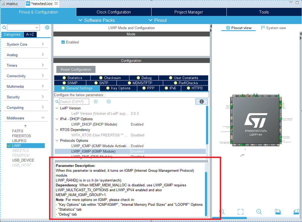

Hi @paulrbryson (Community Member)
Try to read this Parameter description:
You should:
Best regards,
Nesrine
