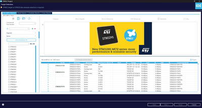

When I am trying to create a new project for STM32C011 series microcontroller, STM32 cube IDE not showing it in microcontroller selection list.
Do i need to install support/package for STM32C0 series, to create workspace for the STM32C0 workspace.

That's strange, for me it's the first one listed. Maybe your network is blocking something when CubeIDE is updating the devices list.
As for the need to install a support package, it's not really necessary at this stage of project creation. I don't have any support for F0 family and it is properly listed on the MCU selection screen.

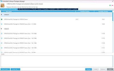

2023-11-06 10:52 PM
Even on STM32 cube MCU packages, i checked, its not listing STM32C0 series.
