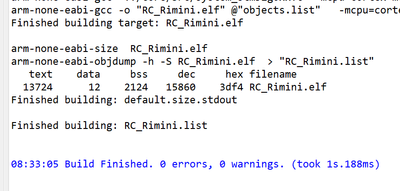

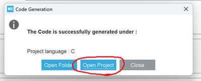

No issues generating code and building here.
After you click Generate Code in STM32CubeMX, press the "Open Project" button to open it correctly within STM32CubeIDE.
