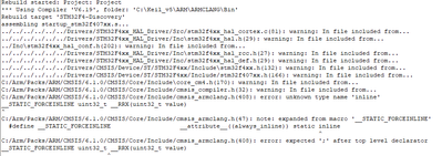

2024-06-19 12:06 PM
These steps that you mentioned I have already done them, when I figure out that the compiler used now is ArmClang but still I end up with the following error message for each single file compiled :
This just the build of simple example on the target STM32F4-Discovery, maybe I miss something
2024-06-19 12:28 PM
Looks to be because of a divergent version of CMSIS, would suggest the project contemporary version from the HAL directories. Let it pull F4 pack, selected Default V6, checkboxed C99

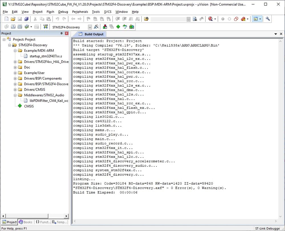

2024-06-19 2:18 PM
I just reinstall MDK again and load gain all needed packs, STM32F4, CMSIS,... with this my problem is solved my, the only explanation that I could found is maybe loading a lot of packs from different vendors it's not a good idea.
thanks for the help
2024-06-19 2:43 PM
If you touch the target setting, picking an MCU, I think it associates with the CMSIS in the pack(s), which is likely several versions newer than anything ST is shipping
