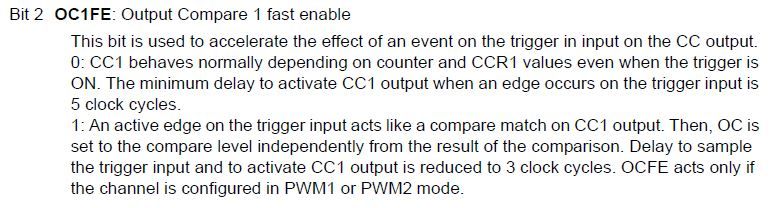

Although they are not accepted by the function HAL_TIM_OnePulse_ConfigChannel(), the configuration requests for channels 3 and 4 response with HAL_OK. This is due to the disable of the IS_TIM_OPM_CHANNELS assert.3.
Yes, we confirm that an assert is missed. In fact, the fast mode acts only in PWM mode.We’re moving the ST Community to a new platform to give you a better and more reliable community experience.
