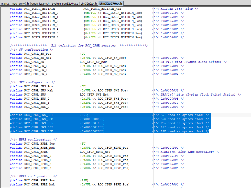

I encountered the same error when switching from stm32g0-hal-1-3-0 to stm32g0-hal-1-4-0. I looked for the definitions that were missing and generating compilation errors in stm32g0-hal-1-4-0 in the old stm32g0-hal-1-3-0 version. I found that in the file stm32g070xx.h from stm32g0-hal-1-4-0 the following definitions are missing:
#define RCC_CFGR_SWS_HSI               (0UL)                                   /*!< HSI used as system clock */
#define RCC_CFGR_SWS_HSE               (0x00000008UL)                          /*!< HSE used as system clock */
#define RCC_CFGR_SWS_PLL               (0x00000010UL)                          /*!< PLL used as system clock */
#define RCC_CFGR_SWS_LSI               (0x00000018UL)                          /*!< LSI used as system clock */
#define RCC_CFGR_SWS_LSE               (0x00000020UL)                          /*!< LSE used as system clock */
I copied the definitions from the stm32g070xx.h file from the STM32Cube_FW_G0_V1.3.0 firmware version into the stm32g070xx.h file from the STM32Cube_FW_G0_V1.4.0 firmware version and I managed to compile the project without errors.eroare fw_g0_v140.bmp
