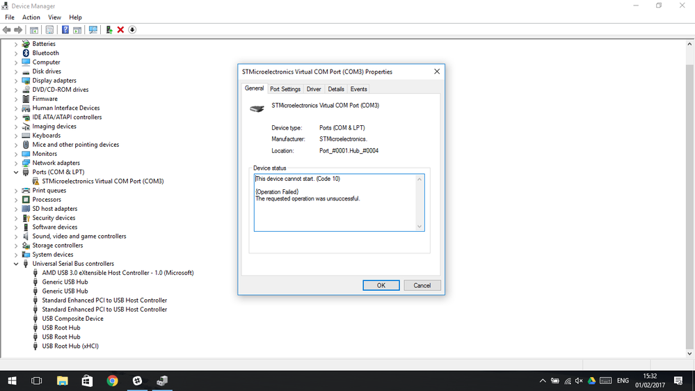

I checked to see if what recognised by Ubuntu / Linux. It is not
Am I missing something?

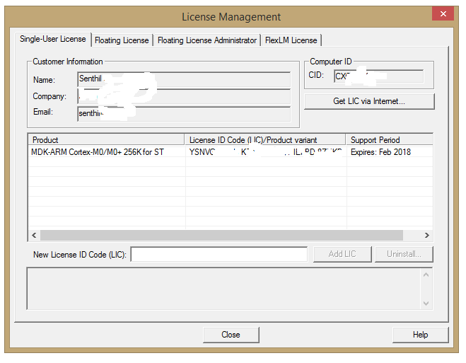

Is this a suitable license?

Your Device Manager tree looks busy with Jungo (good ole Jungo - great s/w) -> can you expand and review your USB tree to be sure that you do not have a stale STM device driver being mapped for this VCP device ? For us, we found that the Total Phase tools were stealing our links because they also use STM processors for DFU. Just be sure that you do not have another widget already installed with the STM drivers. What are the details of your STM device driver ?
Silly request but can you confirm your TARGET CPU matches the details for the STM32F072-EVAL board ? (ie. CPU number & package)

Hey Chendy. Ok, downloaded a fresh copy of the same source code -> imported the CDC_EXAMPLE project -> compiled and tested on our same target board (STM32F072-EVAL). Also initially noted the yellow bang (screens are attached) and reviewed the following important steps:
1) be sure that the USB cable for the ST/LINK is connected - this powers the kit
2) then dock the cable for the USB interface to perform the CDC emulation. Also right-click the current yellow bang mark and select UNINSTALL AND check the box to delete the driver. This will force a fresh start for your device driver links.
3) Install the VCP driver using the installer package supplied with the 1.4.0 VCP driver package (yours appears to be the same but included in our download as well).
4) A compiled HEX file is also posted in this download for your testing.
Curious to hear about your results.
BTW - Any chance you a virus protection s/w running in the background that may be halting this installation ?? Known to happen and be sure you have admin rights.
So some good news. It kind of works.
When I insert the USB, it has the yellow_bang. I then un-install then re-install (in admin mode) - with USB still inserted. It then *sometimes* correctly shows up, and works as a COM port. If I then remove the USB and re-insert the USB, it then shows the yellow_bang again always. I then have to do this loop again: un-install then re-install whilst still plugged in (which again only sometimes works).
