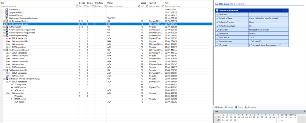

I'm enable to enumerate the USB device and everything seems fine. The picture bellow is my USB analyzer showing the communication between USB host and device.
Everything seems fine, however I'm not getting any package on the Host side with mouse's X and Y position.

Also, I'm not getting any further packages on the USB analyzer.
Am I missing and initialization from the USB host to the device?
