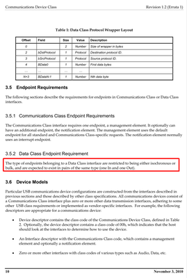

> I would like to change the endpoint type to be Interrupt instead of Bulk
That's a bad idea, and not just because there's no benefit from it, it is also against the standard's requirement:
And I'd expect isochronous not to be supported on host (PC) side either.
