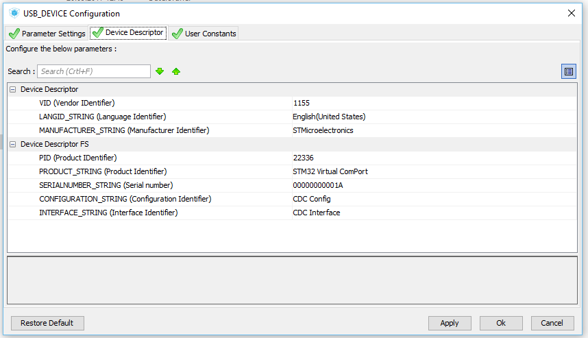

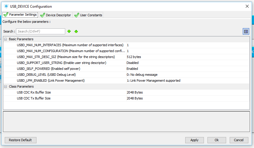

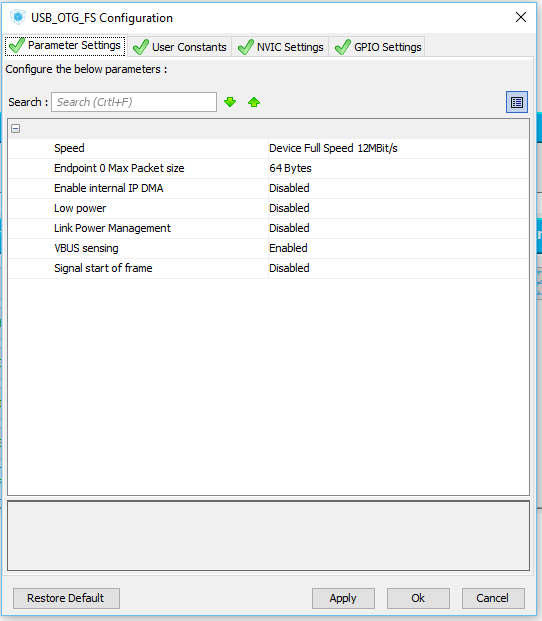

i have a problem with the communication between a USB CDC Device and the PC Software Labview.
On the pictures below you can see my cube settings and labview settings.

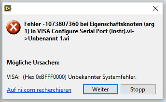

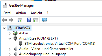

When i try to open the virtuell com port with a terminal programm there is no fail.
But when i try to open the com port with Labview there is very often a fail message.
I don't know what's the reason of the problem.
Other virtuell com port devices doesn't have this problem.
I have 8 pcb boards. Two with STM32F429BIT and Six with STM32F767BIT.
All have this problem.
On some boards this error almost always appears.
On other boards this error appears rather rare.

Hello!
Have Stack and Heap the correct values?
Stack must be 2048+2048 + forOtherUse , at least 0x1400
Heap used By CDC is 540Bytes So you need at least 0x400
2017-10-04 9:03 AM
To test them i have increased both values to 0x3000 but there is no improvement.
