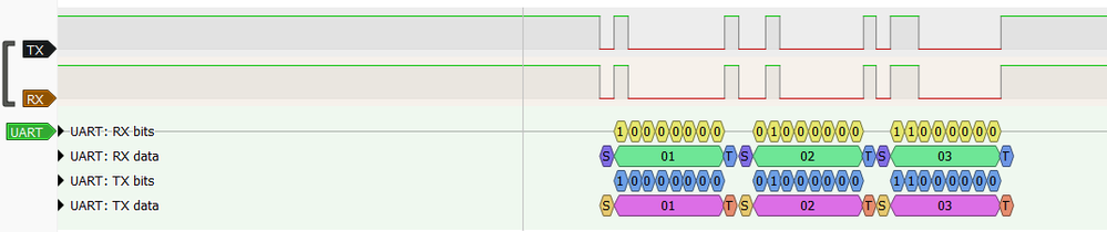

I am testing UART via a loopback test. This shows that the expected data is being sent on TX and received on RX, but the receive function always times out.

@HamzaBeder wrote:This shows that the expected data is being sent on TX and received on RX
It's better to put the image in the post - where we can see it:
You can just copy & paste into the post, or upload the image file.
