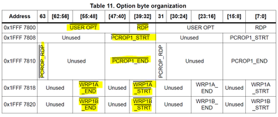

> Do you think OPTIONBYTE_USER configuration can indirectly corrupt OPTIONBYTE_RDP?
Absolutely. Whenever ANY option byte is set, the entire option byte area is erased (including RDP and whatever else is in there), then reprogrammed. At the hardware level, they cannot be modified one at a time. See the excerpt above from the reference manual.
> For your knowledge, at the time of this issue, the entire option byte section was erased.
Thanks. This lines up with what we think is happening--power loss during OB programming.
