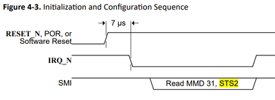

2025-02-13 5:20 AM
Also, I am working on the LAN8670 Phy, I try to read STS2 register as you attached in driver file. But each time I read, I got 0xFFFF values and basically, I cannot get any data from the Phy. It seems inactive, but due to the datasheet image attached below, I read also IRQ_N pin which is zero and newer recovered to back to 1. Have you faced that issue before?
