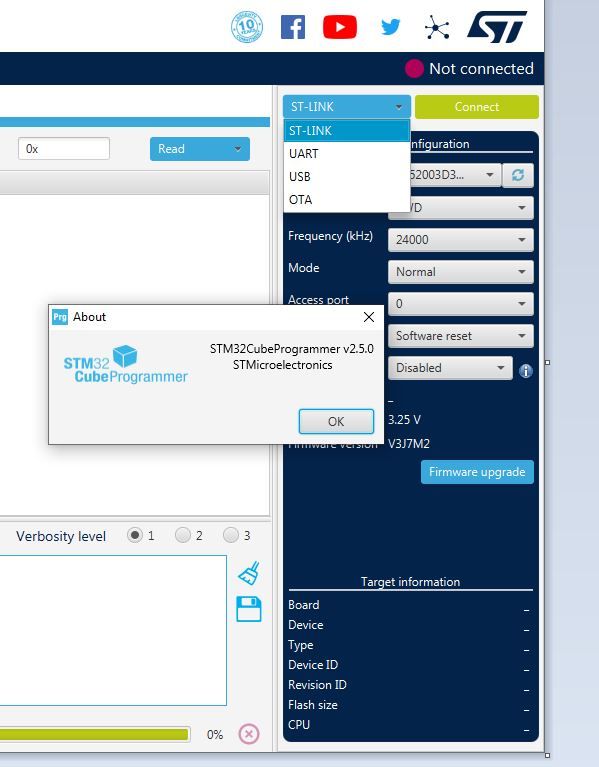

2021-01-13 2:11 AM
The STM32 Cube programmer, at least version 2.5.0 does not have any option to upgrade by CAN pins
