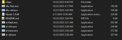

There is a problem if a driver from the dfuse package was previously installed. In this case, it must be uninstalled by deleting the files. I put this in the package I made for internal use with st-link tools, dfu-util and and a tool that converts hex to dfuse, dfu-files. BTW all the tools and chips folder is 1.75MB, zip is 665kB. :)
