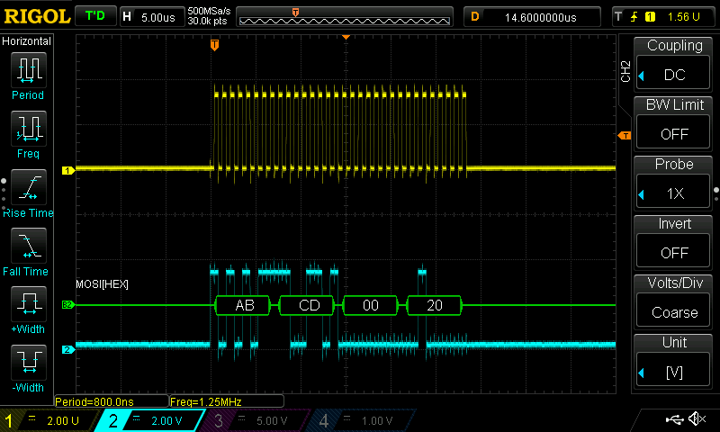

I've configured the STM32F103C8 for 16-bit data transfers. On the scope I can see my 16-bit data which is followed by some garbage data that the MCU is not configured to send. Am I mis-configuring something? How do I ensure that only 16-bits are sent? Here is my code in main.c: I've not included all the other bits about clocks and gpios. Please let me know if you'd like to see those as well and I'll attach them here.

This is what I see on the scope:
2018-06-30 1:34 PM
Try changing:
sizeof(tx_temp)
...to '1'.
2018-06-30 1:34 PM
Suggests that HAL_SPI_Transmit takes a count of units to transmit, not bytes, right
HAL_SPI_Transmit(&hspi1, &tx_temp, sizeof(tx_temp)/sizeof(uint16_t), HAL_MAX_DELAY);
2018-07-01 3:14 AM
Thank you. That worked!
2018-07-01 3:15 AM
Thank you for that clarification. I wasn't aware of that.
