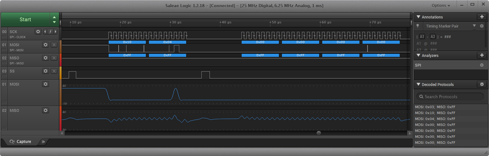

I'm using Atollic True Studio compiler, cubemxcode with STM32L476RGx MCU. I'm trying to send and receive data to Memory FRAM MB85RS64V using SPI.Code below tries to send {0x06, 0x02, 0x00,0x04,0x01, 0x02, 0x03, 0x04, 0x04}, but the logic analyzer shows random garbage data everytime. (Screenshot Included)

Well, did you deliberately exclude the interesting part (i. e. SPI initialization)?
Probably PB12 is the CS pin for the FRAM? CS frames the individual commands, i. e. first pull CS low, send *ONE* command (with parameters like address, data where applicable), and then release CS. Then the same for the next command. Only the rising edge of CS triggers processing of the commands in the flash, FRAM, ...
If you send two commands without deactivating CS in between, you get ... garbage.
And: You're using the non-blocking Transmit_IT. This will return (almost) immediately, before the transmit is actually completed. And then you deactivate CS? This can't work at all. CS must be dactivated only after all bytes have been shifted out. So either you use automatic activation/deactivation of CS (aka hardware NSS), but then use of GPIO PB12 does not make sense. Or you use software NSS via the GPIO pin, but then you must wait until the data has been shifted out completely before you set CS to high.

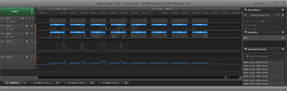

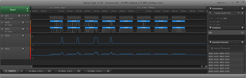

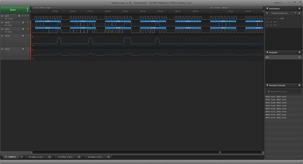

But my MISO gives me all 0xFF all the time. Trying to debug that, give me ideas from the screenshot below.
Thanks
Muthaiah

That's not going to work either: The falling edge of CS starts a new command, rising edge terminates it.
The datasheet of MB85RS64 has clear pictures how this works, e. g. for the write command:
1) set CS low
2) shift out write command
3) shift out address bytes
4) shift out data byte(s)
5) set CS high
CS must go high only after *ALL* bytes for the command (i. e. opcode, address, data) had been transferred!
