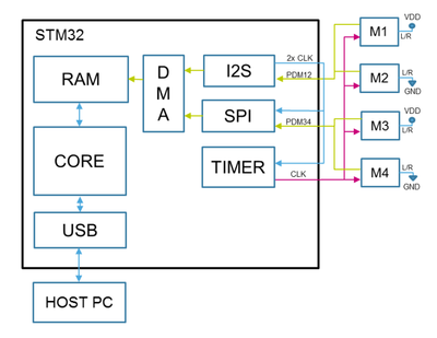

I have gone through UM2212 and UM1901. Due to lack of experience in this field, can you guide me through how I can use this X-CUBE-MEMSMIC1 expansion for sound source localization? I found this diagram helpful and would like to understand how should I code to feed data from cache to Acoustic SL for processing.
