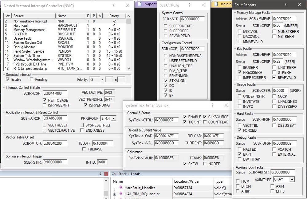

2021-09-08 11:55 PM
If i understood the logic the offset is correct, it is just the offset from the start of flash bank1 start address wich is 0x0800 0000, i corrected from 0x08040000 to 0x08040200 in the post, I wrote it wrong, thanks!
For the registers, here all the informations I can gather from Keil:
I will continue debugging and checking things in the meanwhile.

2021-09-09 1:10 AM
Good reasons for the bootloader to not "__enable_irq();" before launching the app:
2021-09-09 2:34 AM
SCB -> HSFR -> FORCED = 1
BFSR -> PRECISERR = 1
BFSR -> BFARVALID =1
BFAR = 0x00070210, pointing to the Reserved area 0x0001000 - 0x07FFFFFF

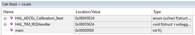

2021-09-13 7:29 AM
update: Still blocked on this Hard Fault.
Checking registers, the fault is Bus Fault, PRECISERR=1, from the application note "the PC value stacked for the exception return points to the instruction that caused the fault."
BFARVALID =1 and the address stored in BFAR is 0x00070210.
In debug mode, I see a strange behaviour.
0x080454E2 BDF8 POP {r3-r7,pc}The POP is executed as last operation of the "HAL_ADCEx_Calibration_Start", here is the local stack:
The code fault stay in a POP instruction, the POP is executed when the SP is empty, and this result in turning r4 (the register who is in charge to hold the address of the timer7 in this case) to 0xE000ED14, and then the timer handler is called with the wrong address, the HardFault occurs!
Tryed adding more instruction on the Boot part to disable all the peripherals ongoing, all of these have been found in different forums and threads about custom bootloader jump, none of them seem to solve the issue
For this reason, i think I't something just in the Application side.
Checked the SCB->VTOR, correctly offsetted.
checked in the .map file and the _Vectors is in the correct place:
__Vectors 0x08040200 Data 4 startup_stm32h723xx.o(RESET)Also RESET seem in the correct place:
RESET 0x08040200 Section 716 startup_stm32h723xx.o(RESET)
!!!main 0x080404cc Section 8 __main.o(!!!main)
!!!scatter 0x080404d4 Section 52 __scatter.o(!!!scatter)Any clue?
