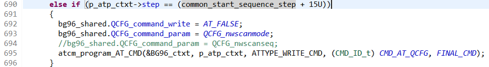

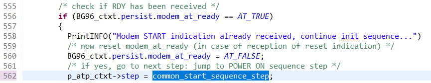

Maybe I found something: in file at_custom_modem_specific.h, in the function ATCustom_BG96_getCmd() we can choose between different power on sequences. There is a variable so we can change its value to select the sequence :
In this case I changed it to common_start_sequence_step +15 to go in the sequence that changes the scan mode :
In my main code, after initialisation (where I did this change), I try to connect to a website to set my RTC from network time. If I do not change my init (common_start_sequence_step) it works perfectly, but if I change my init (common_start_sequence_step + 15) it doesn't work. There is a connection error during handshake.
