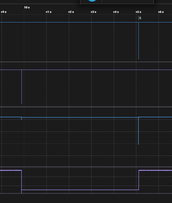

I wait until the Rx pin goes low (which means the bootloader is configured I think), then I send the message which is the first blue spike on the first row.

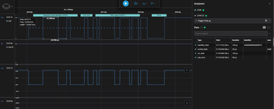

Zooming in we see the error instead of the ACK
If I send with no data it is the same problem
Then the system reset and the purple line (first image) goes back up
There are two rows with the same signal, it is just the analog and digital signals.
