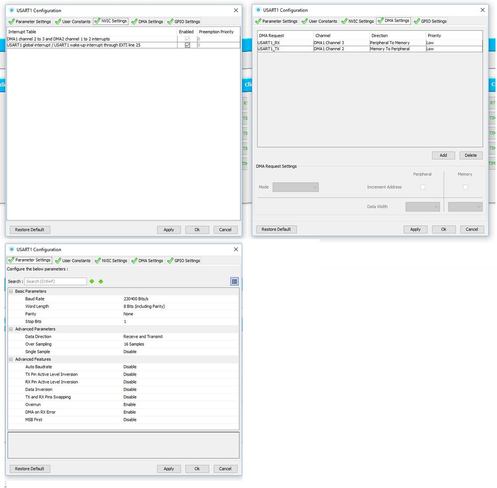

but how did you initialise the port inside the cube ?
To make it work like this, you need to configure the Usart to use the DMA, inside the cube.
