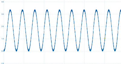

Initial state where a 127 uint16_t sample sin wave is transmitted over UART to the MCU, and is outputted to the DAC

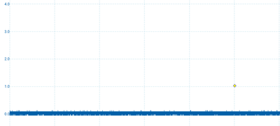

The interrupt is retriggered and the frame: AA 00 00 00 01 is sent containing length and frame rate of 0, and no payload, resulting in no hard fault, and stopping output from the DAC

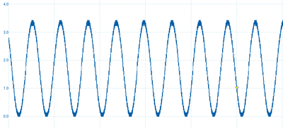

and then returning to the sin wave
Are you able to shed any insight on how HAL_UARTEx_ReceiveToIdle_DMA and HAL_UART_Receive_DMA work? Especially with varying payloads? And how HAL_UART_Receive_DMA can trigger without size being satisfied?
