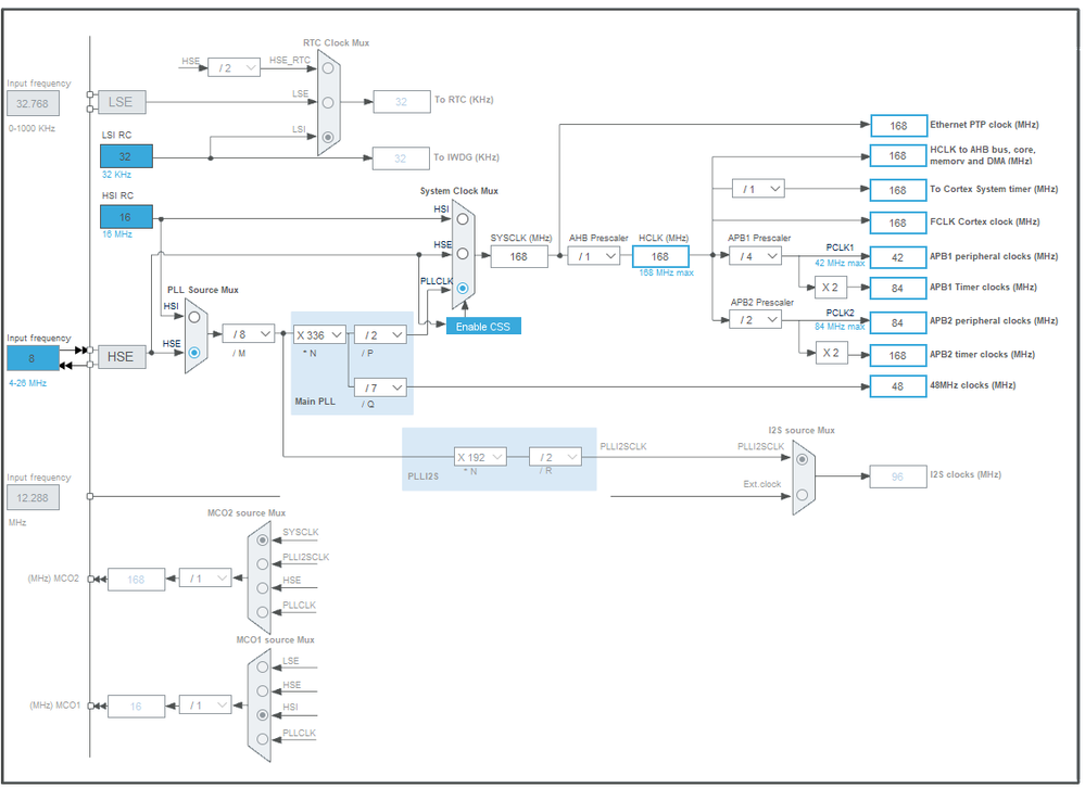

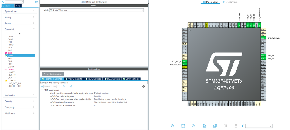

My project clock configuration:My project SDIO configuration:

I have read that SDIO should be configured at lower speeds so tried to set:
hsd.Init.ClockDiv = 0; // = 3, 4, 200, 255But still the same.

FR_NOT_READY often comes from either the GPIO indicating a card is in the socket, or querying the card state
The F4 probably not going to be good in DIV1/BYPASS mode, would avoid use of Hardware Flow control
Needs the PLL running to get a 48 MHz clocking source, typically divides that down by 2 to get the bus level clock to the cards.
The PLL clock can get as high as 75 MHz in not using USB or CRYP/HASH

Interestingly setting SDIO pins (except SDIO_CK) to pull-up according to this post worked:
Tested only reading from SD card, did not test writing.
But why does it work? And will writing work in such configuration?
Is it proper solution to the problem or hack/workaround?
