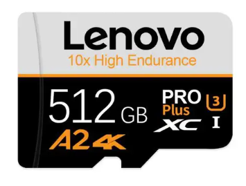

>we were able to communicate with sandisk and other brand sdcards but hp sdcard (Class 10, UHS-I, U1) is not communicating
Solution : dont use this "hp" card.
Where you buy it ? (google shows no source for sd-cards by hp ! )
So maybe same fake product, like my "Lenovo" sd-card from aliexpress (google shows no source for sd-cards by Lenovo ! )
