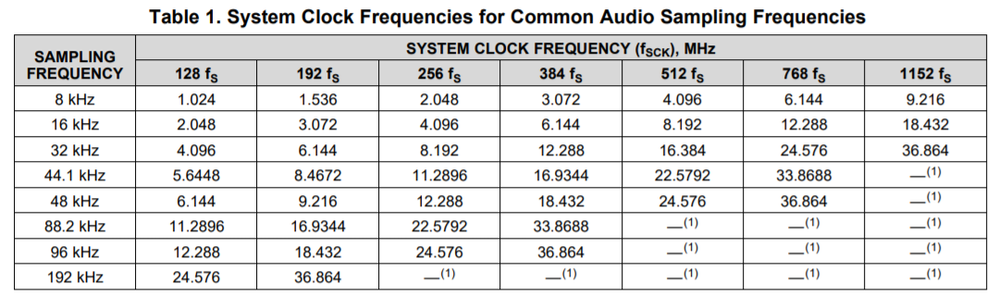

How do I get the best audio clock accuracy using the separate SAI PLL without fiddling manually with all the values?
The SAI clock should be one of these, or as close as possible to be accurate:
I tried just entering the value in CubeMX but clearly it is not possible to get exactly those values so CubeMX cannot manage.
What I would like ideally is a simple way to say I want fs=44.1kHz audio freq for ex and then the tool tries to get a SAI clock as close as possible as one of the possible frequencies (128fs, 256fs, etc.).

Yes, the I2S clock input would need an oscillator. Some audio ADC/DAC/codecs do have integrated oscillator, even fractional-PLL; there are also standalone oscillators, sometimes integrated with PLL, too. I don't say they are cheap, but they are convenient.
Maybe you can pull this out using the HSE oscillator, but first, make priorities. In audio product, it's probably the audio you want to be the most precise. It may be possible to find a solution to generate both the 44k1 and 48k range of frequencies from a single crystal. I'm not going to find it now. Then, prioritize according to required precision (USB-USART-whatnot; system clock as such is probably the least important although that's what most calculators aim at primarily) and try to find the combination of multipliers and dividers to get as close as possible.
2020-09-03 2:46 PM
For example:
6.144MHz / 5 * 147 / 16 = 44k1 * 256
6.144MHz / 5 * 100 / 10 = 48k * 256
6.144MHz / 4 * 125 / 4 = 48MHz
6.144MHz / 4 * 234 / 2 = 179.712MHz

179.712MHz / 4 / 90 / 16 = 31.200kHz, the error is 0.16%, that should be okay.
