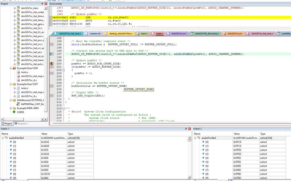

i tried the SAI_AudioPlayback example for the h745 discovery board. I'm using Keil and with the keil 5 armcc compiler everything works fine.
Now i switched to armclang 6 and replaced the "libPDMFilter_cm7_keil_wc16.lib" with "libPDMFilter_cm7_gcc_wc16.a" i can compile & run the program but soundoutput is not working.
i attached a screenshot. for the input i get pdm values but pcm is always zero. If i compile with armcc the pcm values are not zero.
is there something i have to configure? i think maybe it is some signed/unsigned problem? does anybody have a hint what can cause this error?

2022-10-25 6:22 AM
It's because of D-cache. Look at audioPdmBuf addresses - on the right it's located at a data/bss sections, while on the left it's at some dedicated memory region most likely configured in MPU. For testing purposes just do not enable the D-cache.

2022-10-25 6:32 AM
This is the debug output with the armcc compiler
The dcache gets invalidated by the program(it's the st example) and with armcc everything works fine so my conclusion was: it is something compiler related but maybe this is misleading?
(but i will check the dcache anyway because i'm not saddle-proof regarding this topic)

2022-10-26 10:54 AM
Start by adjusting the audioPdmBuf definition to get it to the same 0x38000000 address. For Clang it should be similar to GCC:

2023-03-08 6:16 AM
In the first post, the breakpoint appears to have stopped execution before actually calling AUDIO_IN_PDMToPCM() function, as consequence of debugging optimized code. If it was before the first call to that function, the output buffer might've been cleared from the startup code if it's a global variable.
2023-03-08 8:35 AM
on both screenshots i stopped in line 200 after the lib was called(the marker is the yello arrow, not the blue one)
on both screenshots the variable is placed at the same memory location @piranha!! so no! this likley has nothing todo with d-cache or anything(or it is something this lib needs to handle differently internal, which i doubt atm)
with armcc it works, with armclang not. (same code)
