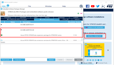

You can also upload x-cube-azrtos-g0 from cubeMx and generate your code:
