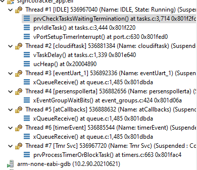

Even though that showed the tasks in the debug view
it did not do correctly the stack unwinding.

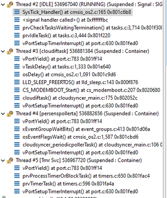

When finally choosing the NTZ settings, It goes do the full stack unwinding!
Again, this is such an important feature, and nevertheless it is so hard to info about the feature.
