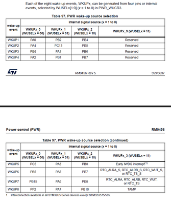

One quick update:
I found the the wakeup source selection in the manual and learned of its existance:
I also noticed that i configured the sleep duration not to 1 minute but to 30 minutes last week since i testet the sleep current. So user error on my side.
But I have on question: is the wakeup source selection required and if yes can the wakeup pins of wkup7 be used and the rtc wakeup at the same time or are they exclusive?

2024-12-19 8:04 AM
Just in case this is interesting for anyone: The magic missing line is the HAL_PWR_EnableWakeUpPin(PWR_WAKEUP_PIN7_HIGH_3) call which is in a user-code section and never generated by CubeMX, no matter how it is configured: https://github.com/STMicroelectronics/STM32CubeU5/blob/main/Projects/NUCLEO-U575ZI-Q/Examples/PWR/PWR_LPMODE_RTC/Src/stm32u5xx_hal_msp.c#L114
