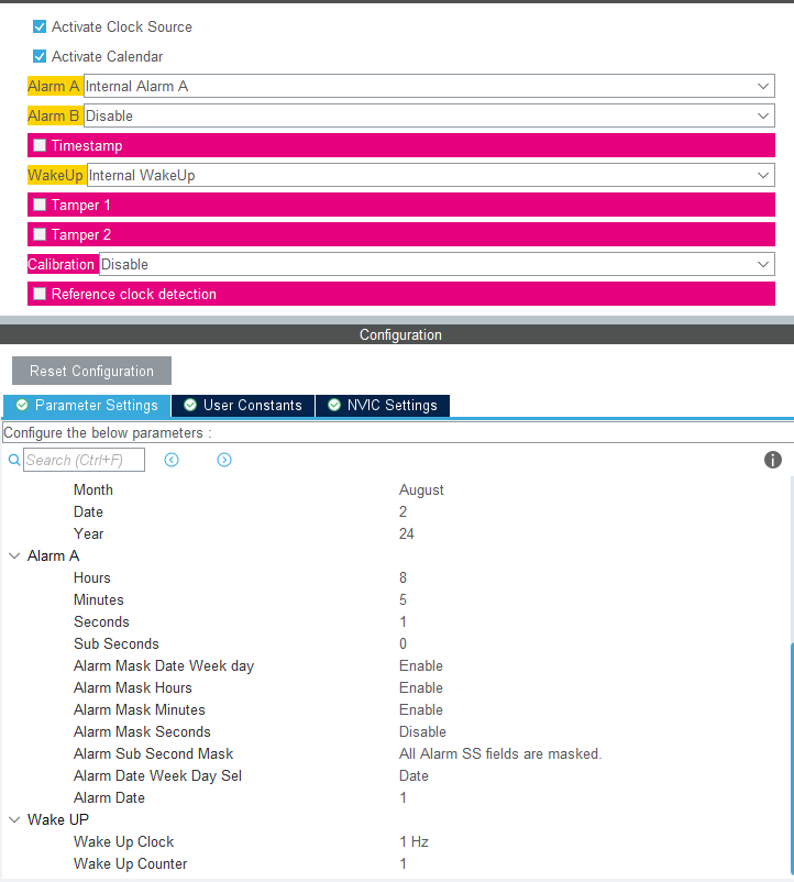

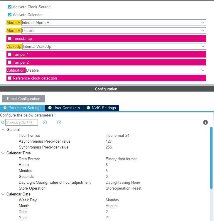

Because it's been so long, I've forgotten how I set it up back then. The problem seems to stem from the difference in settings between the `RTC_FORMAT_BIN` and `RTC_FORMAT_BCD` parameters, which led to different results. Also, the modulo operation is very important. I'm providing the code for your reference; the code might be incorrect, but it's for informational purposes only.

/** Initialize RTC Only
hrtc.Instance = RTC;
hrtc.Init.HourFormat = RTC_HOURFORMAT_24;
hrtc.Init.AsynchPrediv = 127;
hrtc.Init.SynchPrediv = 255;
hrtc.Init.OutPut = RTC_OUTPUT_DISABLE;
hrtc.Init.OutPutRemap = RTC_OUTPUT_REMAP_NONE;
hrtc.Init.OutPutPolarity = RTC_OUTPUT_POLARITY_HIGH;
hrtc.Init.OutPutType = RTC_OUTPUT_TYPE_OPENDRAIN;
if (HAL_RTC_Init(&hrtc) != HAL_OK)
Error_Handler();
/* USER CODE BEGIN Check_RTC_BKUP */
/* USER CODE END Check_RTC_BKUP */
/** Initialize RTC and set the Time and Date
sTime.Hours = 8;
sTime.Minutes = 5;
sTime.Seconds = 0;
sTime.DayLightSaving = RTC_DAYLIGHTSAVING_NONE;
sTime.StoreOperation = RTC_STOREOPERATION_RESET;
if (HAL_RTC_SetTime(&hrtc, &sTime, RTC_FORMAT_BIN) != HAL_OK)
Error_Handler();
sDate.WeekDay = RTC_WEEKDAY_MONDAY;
sDate.Month = RTC_MONTH_AUGUST;
sDate.Date = 2;
sDate.Year = 24;
if (HAL_RTC_SetDate(&hrtc, &sDate, RTC_FORMAT_BIN) != HAL_OK)
Error_Handler();

myRun.clock.sdatestructureget = sDate;
myRun.clock.stimestructureget = sTime;
/* USER CODE END RTC_Init 2 */

/* RTC second interrupt */
void HAL_RTCEx_WakeUpTimerEventCallback(RTC_HandleTypeDef *hrtc)
static int sec_cnt = 0;
if (hrtc->State == HAL_RTC_STATE_READY)
rtc_getCalendarTime(&myRun.clock);
triggerLcdUpdate(1); // Trigger LCD refresh
}My program's function is to display the current time on the LCD screen in real time every second, and the `dispCalender()` function should be called once every second. For your reference only!
